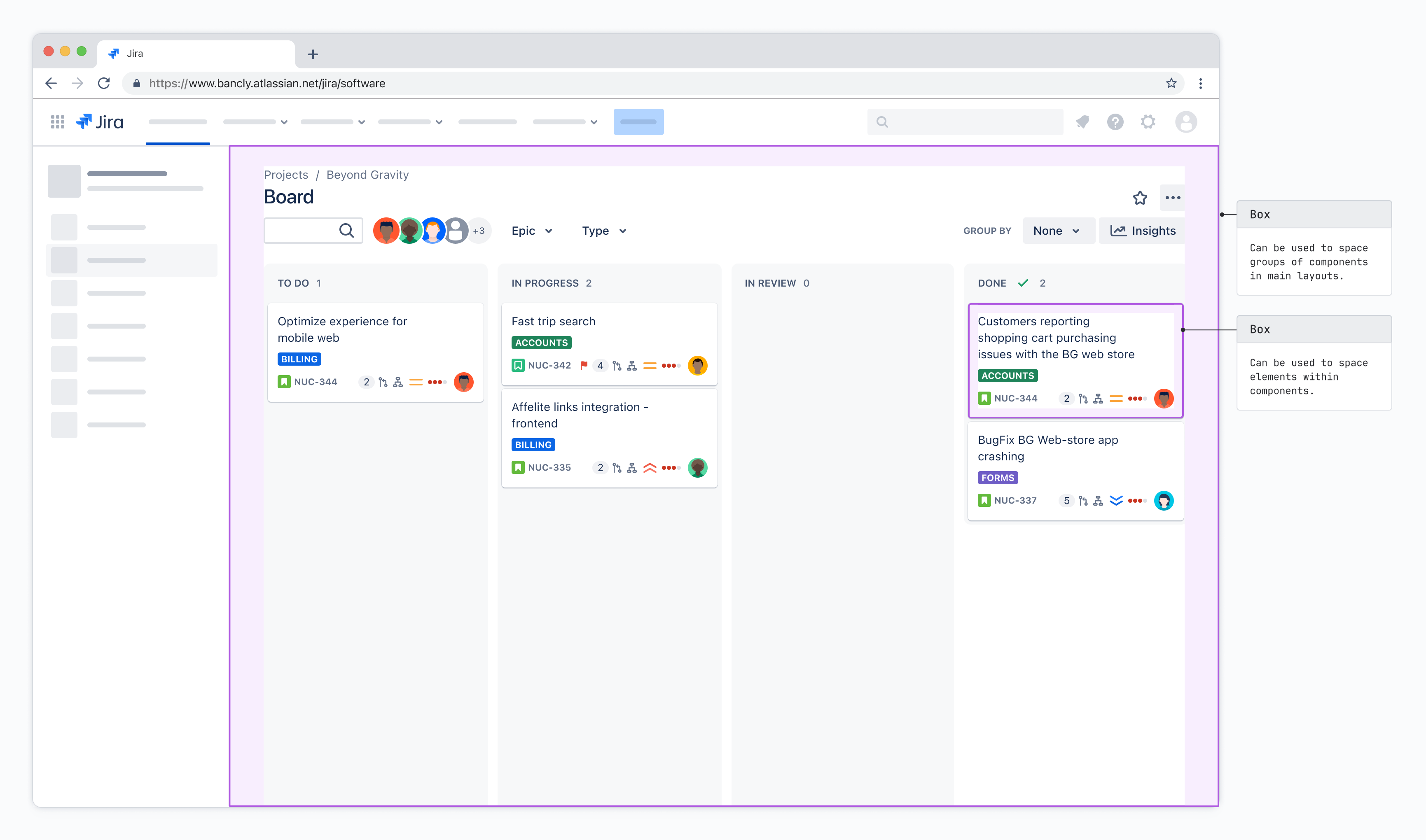

Use primitives for composing layouts. Primitives are not currently available in Figma, so the first step in implementing primitive components is identifying where they might fit in a given design. This involves breaking down a design into its core layout components to as granular level as is useful.
You might like to think first about breaking down a page into Box containers, identifying larger pieces of a design that function in a similar manner or fulfill a singular purpose in a layout and grouping them together under a Box.
Screenshot of a typical Jira board with swimlanes. Various areas are highlighted as examples of how Box containers are used for layout

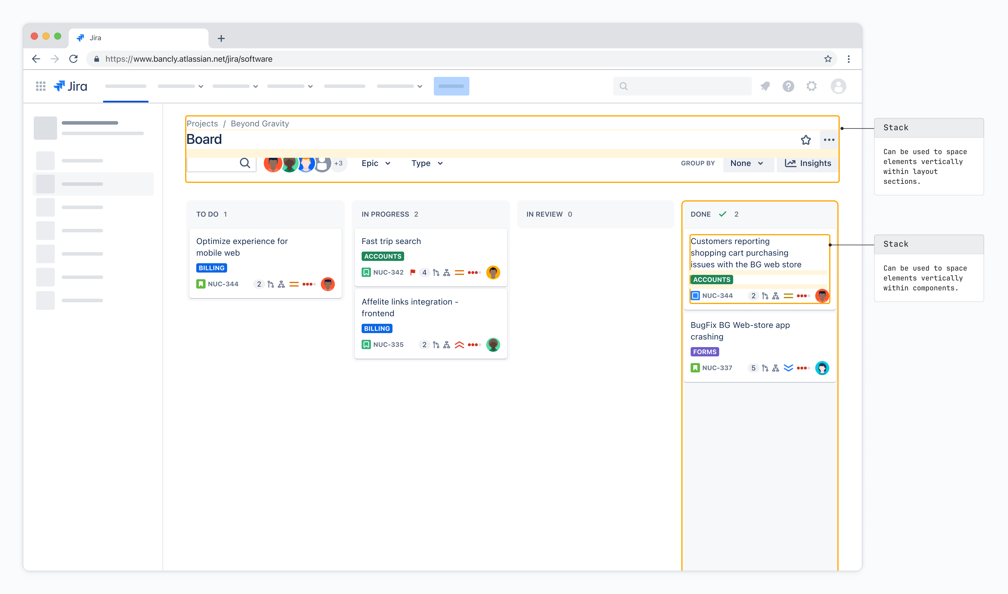

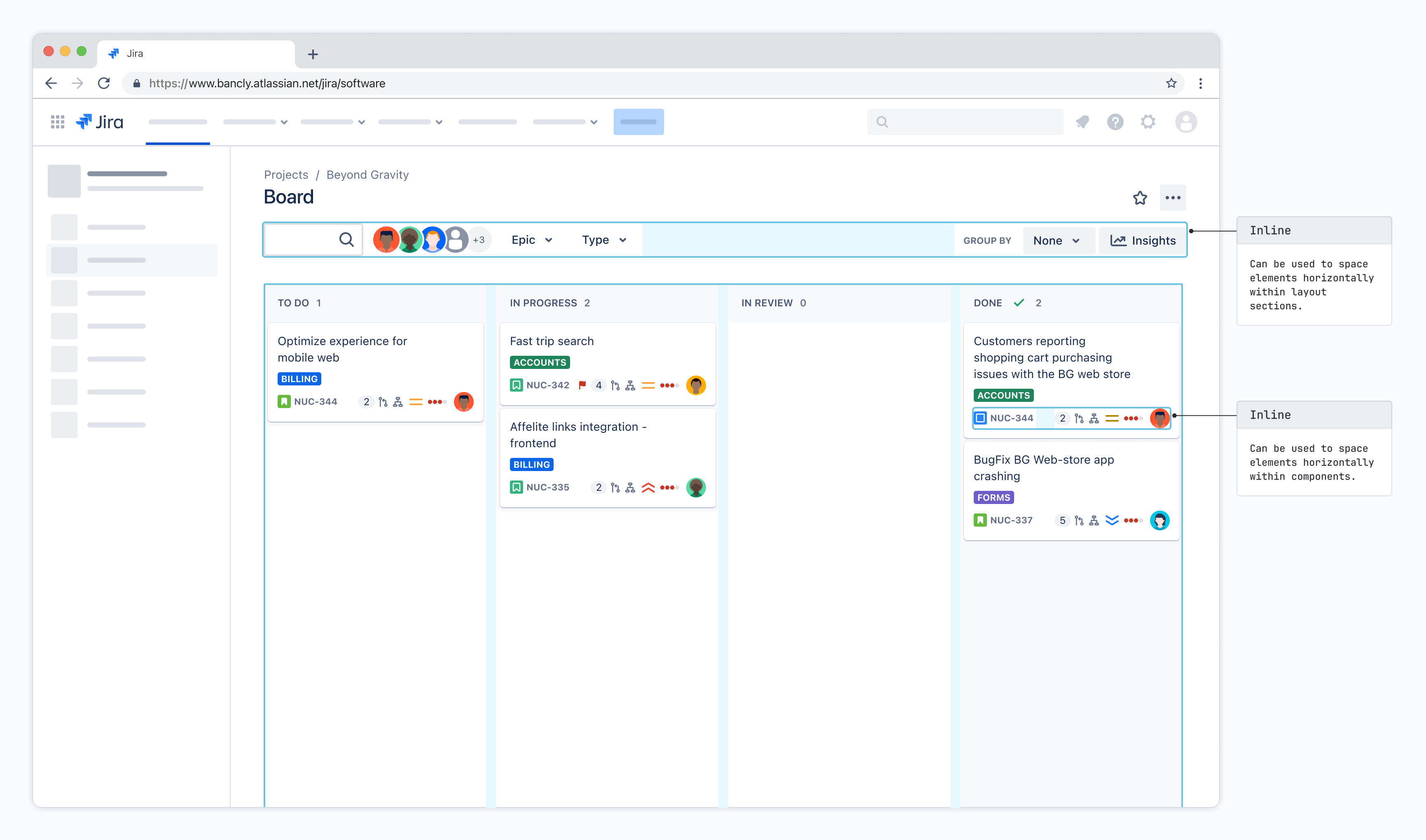

The behavior within and around these boxes can then be broken down into their horizontal Inline and vertical Stack components.
The ESLint rule use-primitives offers suggestions for possible primitives to apply in a layout.
Screenshot of a typical Jira board with swimlanes. Various areas are highlighted as examples of how Inline containers are used for layoutScreenshot of a typical Jira board with swimlanes. Various areas are highlighted as examples of how Stack containers are used for layout
