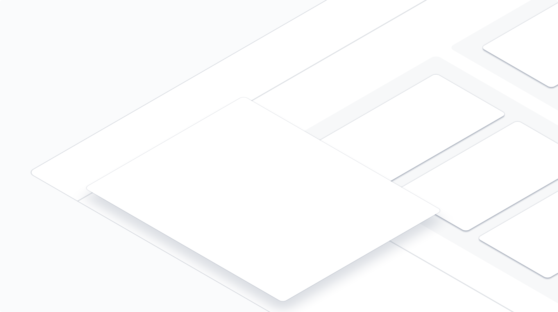

Elevations are the layered surfaces that form the foundation of the UI. They create a blank canvas where other UI will be placed, such as text, icons, backgrounds, and borders.
Most elevations consist of surfaces and shadows. Together, surfaces and shadows give the impression of lift or depth. Elevations can guide focus through layering, or indicate that the UI can be scrolled, slid, or dragged.
Applying elevations
The elevations use design tokens to apply different surface levels. The highest two elevation surfaces, raised and overlay, are paired with shadows to create more depth.

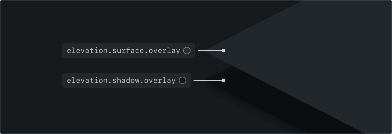

Elevations in dark theme
Shadows can be harder to see in dark mode, so dark mode elevations also rely on different surface colors. Imagine that the surfaces are distantly lit from the front — the higher the elevation, the lighter the surface looks.
Raised and overlay surfaces are still paired with shadows for added depth and consistency in dark mode.

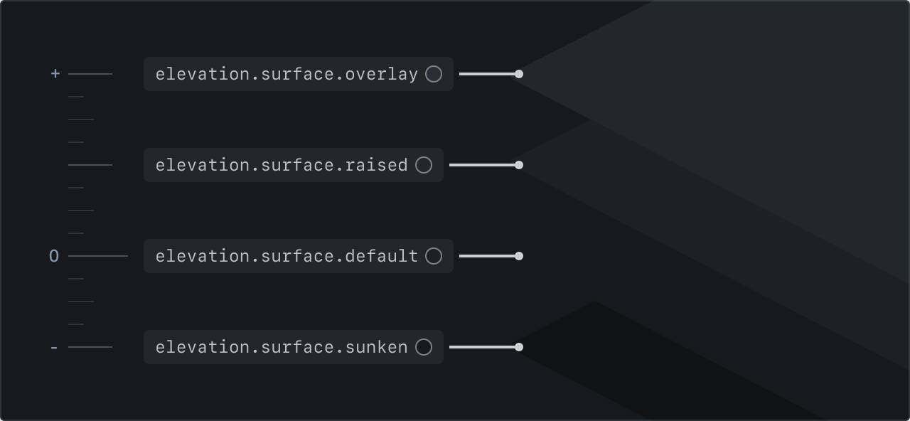

Types of elevations
There are four basic elevation levels:
  1. Sunken
  2. Default
  3. Raised
  4. Overlay
There is also one "overflow" elevation for special cases.

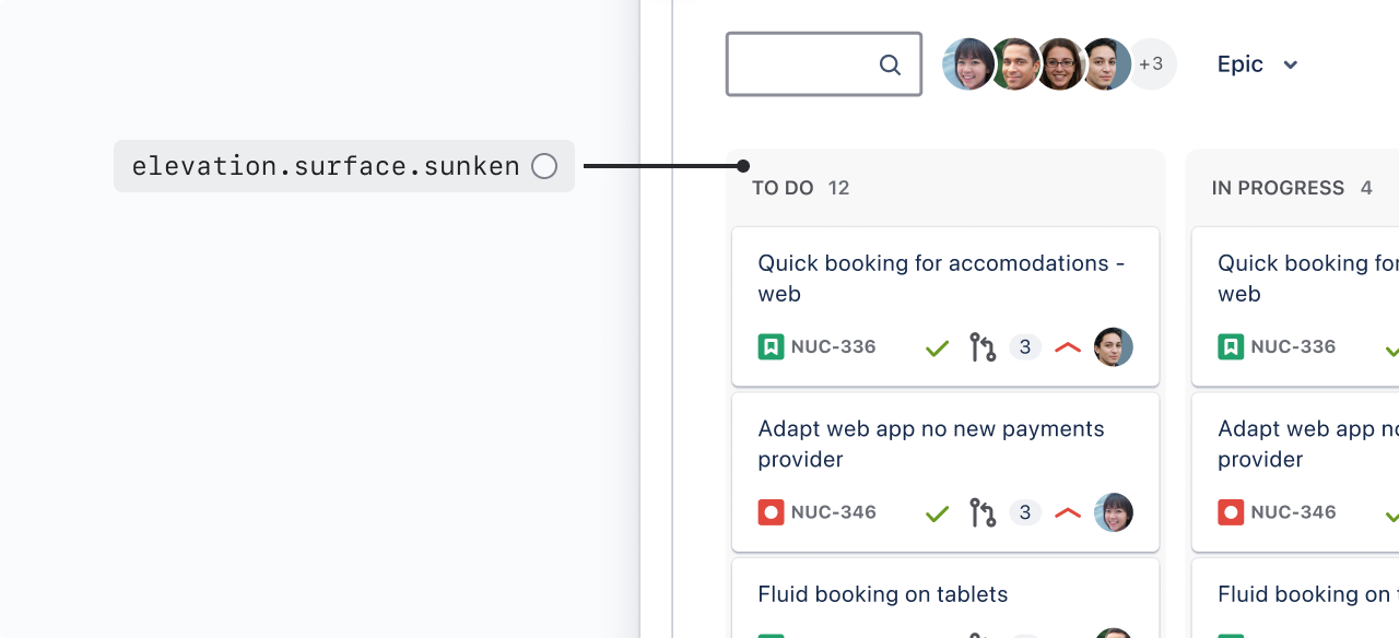

Sunken

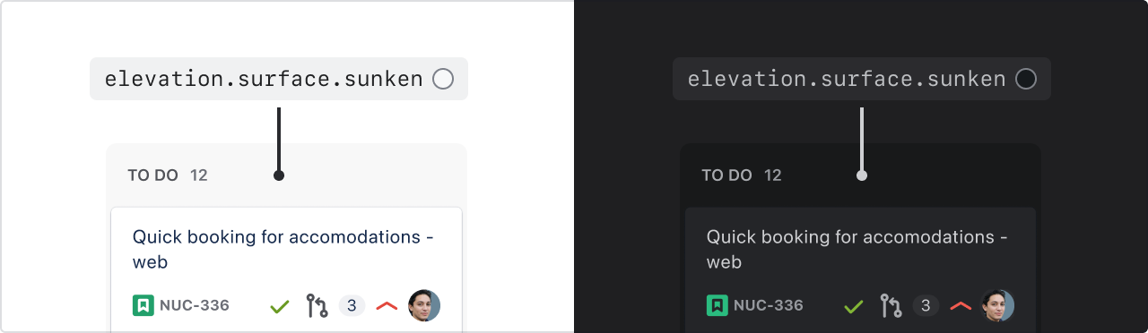

Sunken is the lowest elevation available. The sunken surface creates a backdrop (or well) where other content sits. Columns on a Kanban board are a good example of the sunken elevation.
Only use sunken surfaces on the default surface level. Don’t apply sunken elevations on raised or overlay elevations. To differentiate areas of the UI in other ways, use whitespace or borders instead.

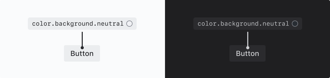

Using elevation.surface.sunken vs color.background.neutral
Although elevation.surface.sunken and color.background.neutral tokens may appear similar in light mode, they behave differently in dark mode. Here are the main differences between the two:
elevation.surface.sunken is an opaque (solid) token that darkens in both light and dark modes. Use this token as a backdrop to group content or elements together (such as a kanban board) on the default surface.
color.background.neutral is a token that uses a transparent color. It darkens in light mode and lightens in dark mode. Use this token when you need the background to adapt to different elevations, which is relevant in dark mode since surfaces change depending on what elevation you’re on.

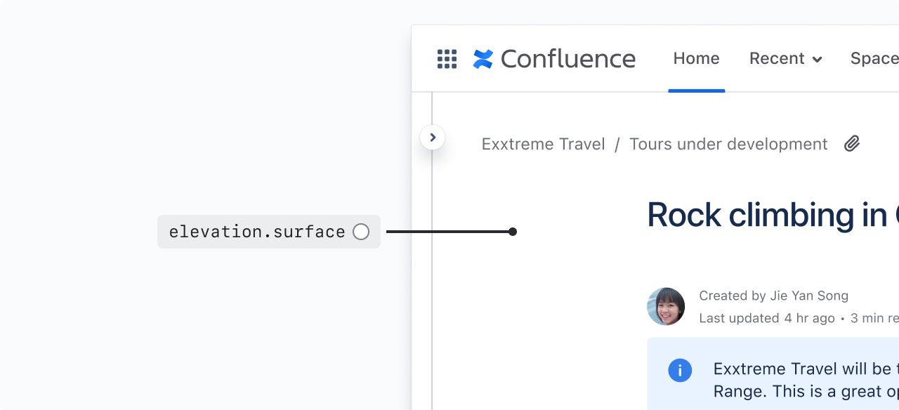

Default
The default elevation is the baseline with respect to all other layers. It represents a flat UI surface with no visual lift, such as a Confluence page.
Use elevation.surface as the starting point for body content when building a UI. To create flat cards, pair with a border.

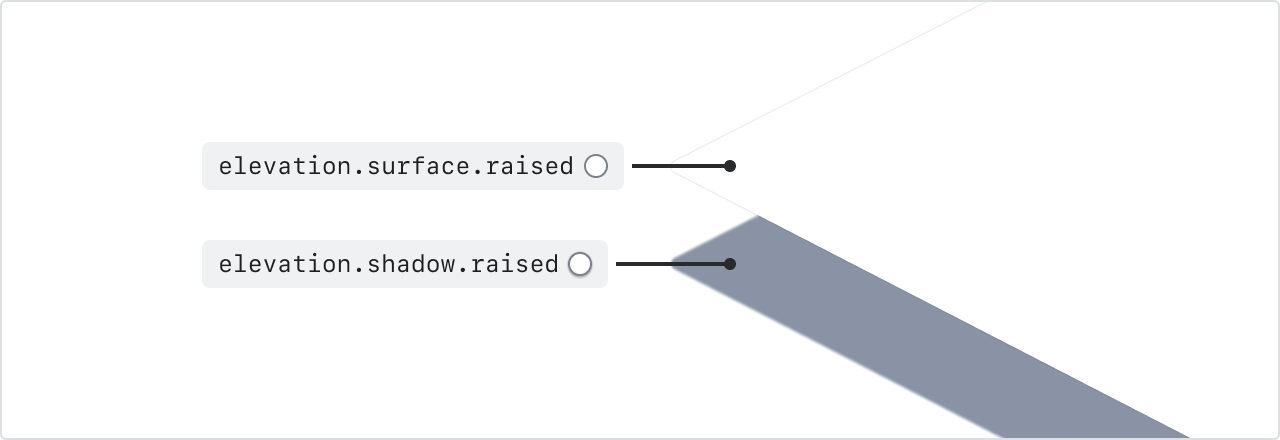

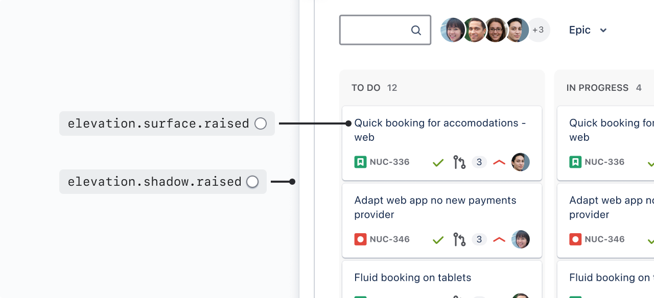

Raised
Raised elevations sit slightly higher than default elevations. They are reserved for cards that can be moved, such as Jira and Trello cards. In special circumstances, they can be used for cards as a way to provide additional heirarchy or emphasis.
Always pair elevation.surface.raised with elevation.shadow.raised. This is particularly important in dark mode, where raised surfaces are lighter to help differentiate elevations.

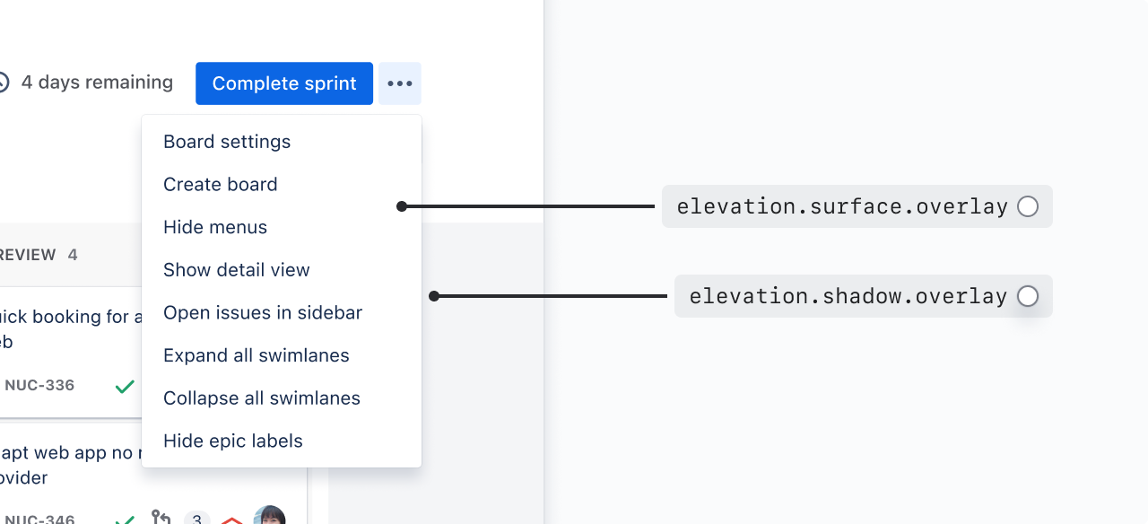

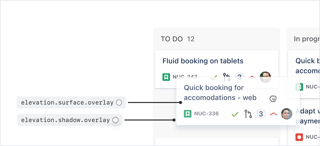

Overlay

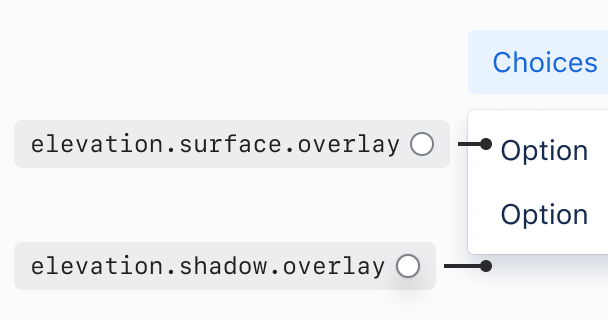

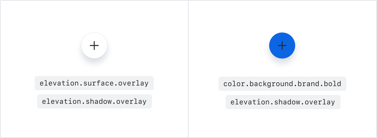

Overlay is the highest elevation available. It is reserved for a UI that sits over another UI, such as modals, dialogs, dropdown menus, floating toolbars, and floating single-action buttons.
Always pair elevation.surface.overlay with elevation.shadow.overlay. This is important in dark mode, where overlay surfaces are lighter to help differentiate elevations.
Overlays can stack on top of other overlays.

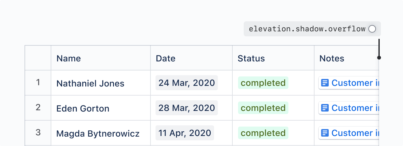

Overflow
Overflow is a shadow indicating content has scrolled outside a view. It can be used for vertical or horizontal scroll. An example of overflow shadows is the horizontal scroll in tables on a Confluence page.
If box shadows are not technically feasible, use the combination of elevation.shadow.overflow.spread and elevation.shadow.overflow.perimeter to replicate the overflow shadow.

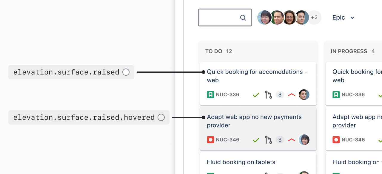

Hovered and pressed
Elevations use surface color changes to communicate hovered and pressed states. Use the hovered and pressed elevation tokens to create these visual changes.

Do
Use the recommended hovered and pressed tokens for interaction states on elevations.

Dragged
Use the overlay elevation for any UI that is being dragged. Once moved, it returns to its original elevation.

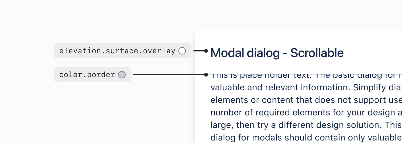

Scrolled
When scrollable content exceeds the available area, a border or overflow shadow can be applied at the point the content is cut off to indicate there is hidden content that can be scrolled back into view.
A border is the default approach for scrolled content and can be seen in modal sticky headers and footers, and top and side navigation.
Overflow shadows are reserved for experiences where a border might be easily missed, such as in very small UI or tables that use borders to separate cells.
Both approaches should apply the appropriate surface token where the content is being hidden.

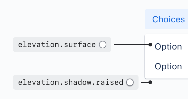

Raised and overlay elevations have dedicated surface and shadow pairings.
Do
When creating elevations, always pair matching surface and shadow tokens.
Don’t
Don't mix different shadow and surface elevation tokens.

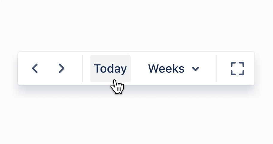

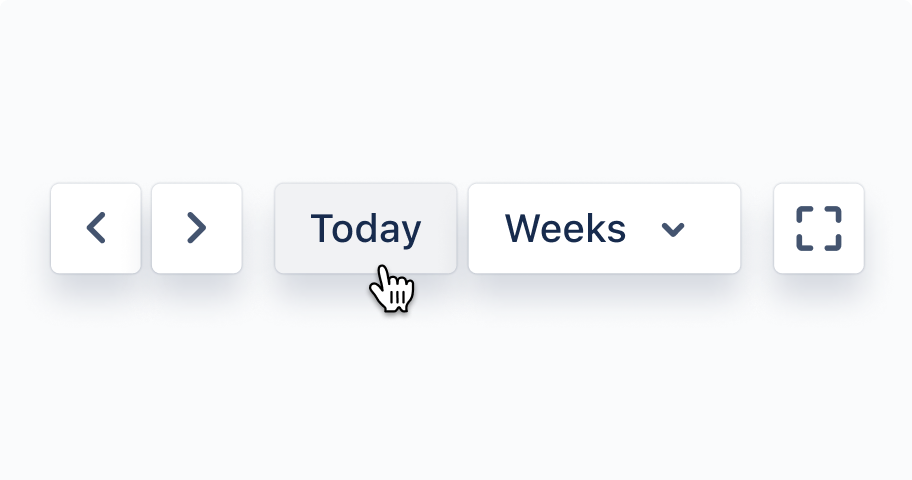

Limit the use of overlay elevations by grouping related buttons together in a floating toolbar if they are required to sit over another UI.
Don’t
Don’t have more than one floating button next to each other.
